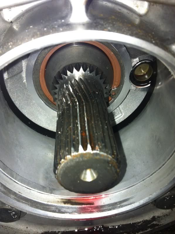

Looks like I got bitten by Blake as well:
:tdown:

Now you have me wondering. I have gone low 10s on a PG 4l80. Defenatly have the most passes. 300 plus. I have never had a failure. But I pulling the trans for a refresh and I too have the 27 spline conversion. I was told it was a hardend shaft. I'll post up what I find. I suspect mine is bent.
denny

BTW- with the twisted output shaft I use to get a humming noise over 100 mph.
Make sure you have all of your billet parts that you paid for... I was one out of three... Best luck to you. Please post what billet hard parts you find... It would he nice to know due to you running super low 10's..
