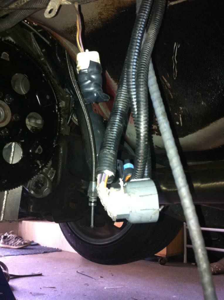

Anyone have a pic or can describe what needs to be modded for clearance. I found this from GB, but no pic.
Thanks for the help!!
Len
When you guys get your transmission controller harnesses, PLEASE clearance the damn transmission plug to clear the frigging prop shaft. Everyone tells me "I know I know", then the harness gets dragged off. I will put up pics of a harness I just did for Erue. The mod gives 5/8" to 3/4" MORE clearance between the harness and the prop. I've NEVER had a problem with mine and drove it daily until I busted the body mounts on the driver side on these shitty Middletown roads.

Ditto here, I zip-tied it up. Mine JUST clears my HD propshaft. I came across this late last night & was wondering what he did to get the extra 5/8 to 3/4 clearance?

silicone

I think he used epoxy to shape the harness out of the way. Same here, just clears my Gilbert....
