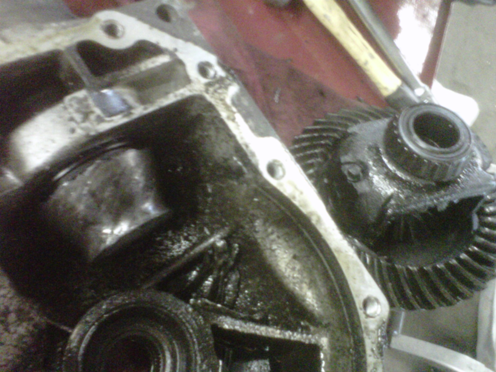

I happened to have a spare blown up front diff at home so last night I split the case to take a look inside, learned a few things but more to come.
Notice what is left of the pinion gear.

I am also toying with the idea of building a custom solid spacer instead of the crush sleeve. As you can see in the diff I pulled apart the pinion gears are shredded. This most likely came from the lack of preload on the pinion shaft bearings. Several possible reasons this could happen (flange replacement, seal replacement, or just abuse).
Since I have machine tools available to me, making a solid spacer instead should beef up the diff some. Time will tell I guess. Heading today to get a good used diff and will tear it apart for inspection, solid spacer setup, new seal, etc.
