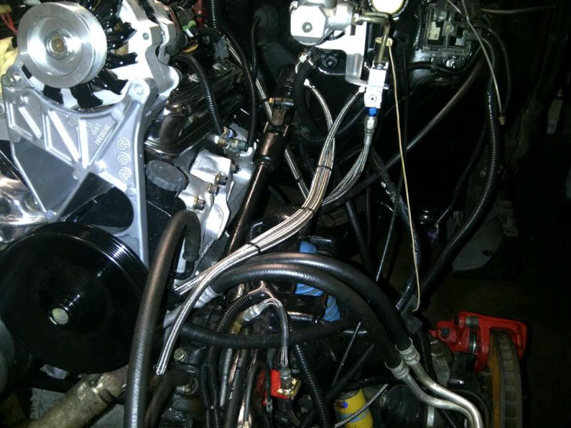

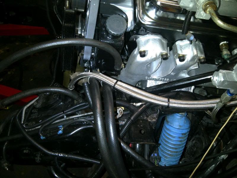

Here's my setup...

Looking over your setup and how i did mine , i would say it appears to be correct . The 2nd to last pic of your engine bay seems to not have the low pressure return line connected , although i assume that was just your progress point in the install and is connected now .
I never did find the exact year and model of my unit , so it could be possible the fluid travel is reversed . Id say that or the rod is just longer than needed . When the unit pressurizes initially at start up your saying the brakes apply ?
I didnt have any brake issues other than the brake light switch needing to be adjusted . Try swapping the lines and see if the problems still there . If not , id say grinding/cutting the end of the brake rod may solve it .
x2 on the clean engine bay , looking real good .

I bought this truck as a roller and it was somebody elses project that never happened. The hydroboost unit came with the truck but wasn't installed, just mounted to the firewall. I don't know where it came from either. From every diagram I see on the web it is plumbed properly. I'm wondering if there's some air in the system because I didn't really give it much attention. I started the engine for the first time so I was looking for leaks, setting the timing etc...
The low pressure wasn't hooked up the time of the pics, it is now. I will fire it up again and try to pump the brakes and see if I can get them to function properly. The rod doesn't feel like the problem because the pedal feels good and the rod isn't pressing against the master when the truck is off. All I had to do was adjust the brake switches... Everything was fairly easy. I will look at it with more attention now that the rest of the truck is good.
