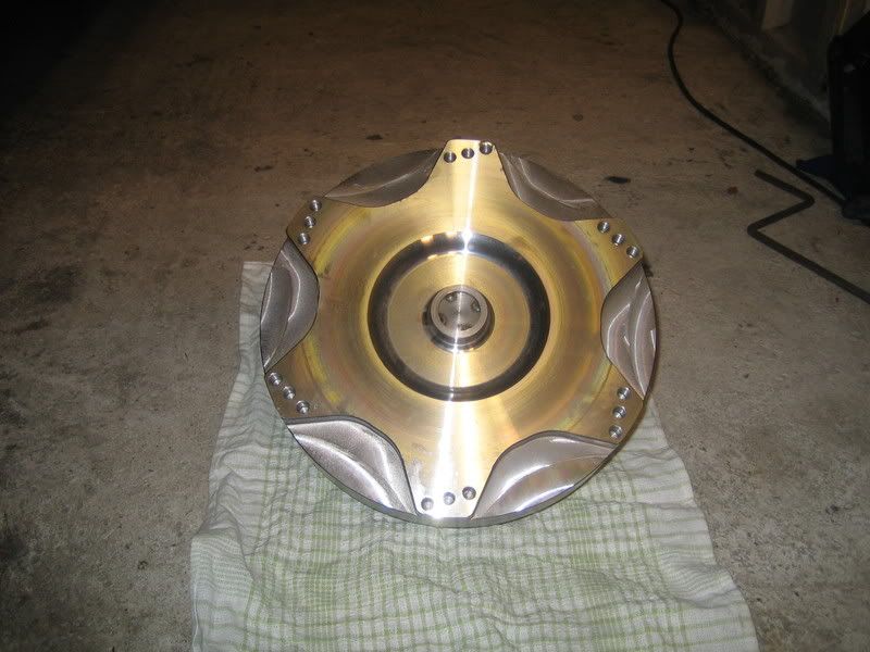

I told you already what to try.....That looks like a real nice billet tc. Lock it as soon as it shifts into 2nd gear, then the slippage won't matter except for the launch, and I told you how to help tighten that up. Try it before pulling that tc out.

Have you confirmed the stall speed on the brake and flash? Before going further I would confirm these too. Otherwise moving forward to another TC would leave you guessing what you "don't" want again.
Normally hold the brake pedal and ease into the throttle while watching your RPM. When you feel the truck start to want to move forward that is your stall speed.
Flash stall is typically 300-500rpm more than your brake stall speed. You should cruise in third and punch it to the floor. While watching your rpm's shoot up fast before it starts to pull forward is your flash stall. The loose converters I have felt flash much higher than 500rpm more than brake stall.
It has to do with the design of the stator and how the fluids creates a centrifugal force to get it moving. Top rated TC builders have some pretty wicked custom built TC's that will cruise at low rpm and flash tight with a higher brake stall. Your build will effect the outcome of a custom TC.

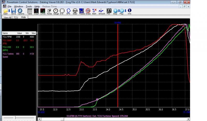

Well, I did some datalogging this morning just before breakfast with relatively empty roads. I had to collect my new Black Air DVD from the post office! (Thanks Paul!!)
At the suggestion of one of our Dutch members, I reprogrammed the TCC on the Ty to lockup at about 8mph. The engine bogs quite a bit when downshifting but that's by the by...
The result?
Holy crap the truck is fast now! None of that rubbish high rpm/sluggish pulling away from the line. This test now rules out the trans slipping and confirms the TC is rubbish.
I have received the Hygard fluid but at this point wonder if it's going to be enough. I want a stall speed of 2400-2800 at about 10psi. I was getting 2800rpm at 4psi and 50% slip. The TC just isn't putting the torque through the wheels. What I read was that the Hygard will make the rpms will come down by maybe 1000? I suppose I am guessing until I try. I'll have to think about it.

Here it is.
You can see the green line climbs steadily after a small gap. TCC lockup was set for about 6kph.
The purple line is the Turbine speed and that matches the vehicle speed exactly, the whole way up. If there was any transmission slip, these two lines would separate.
The truck felt completely different. I will set the TCC a bit higher as it bogged when I came to a stop but it was so much more fun to drive. There was no turbo lag either.
I need a really tight stall for this truck. Boost appears at 2400 rpm again. I don't want a converter any looser than that really.
