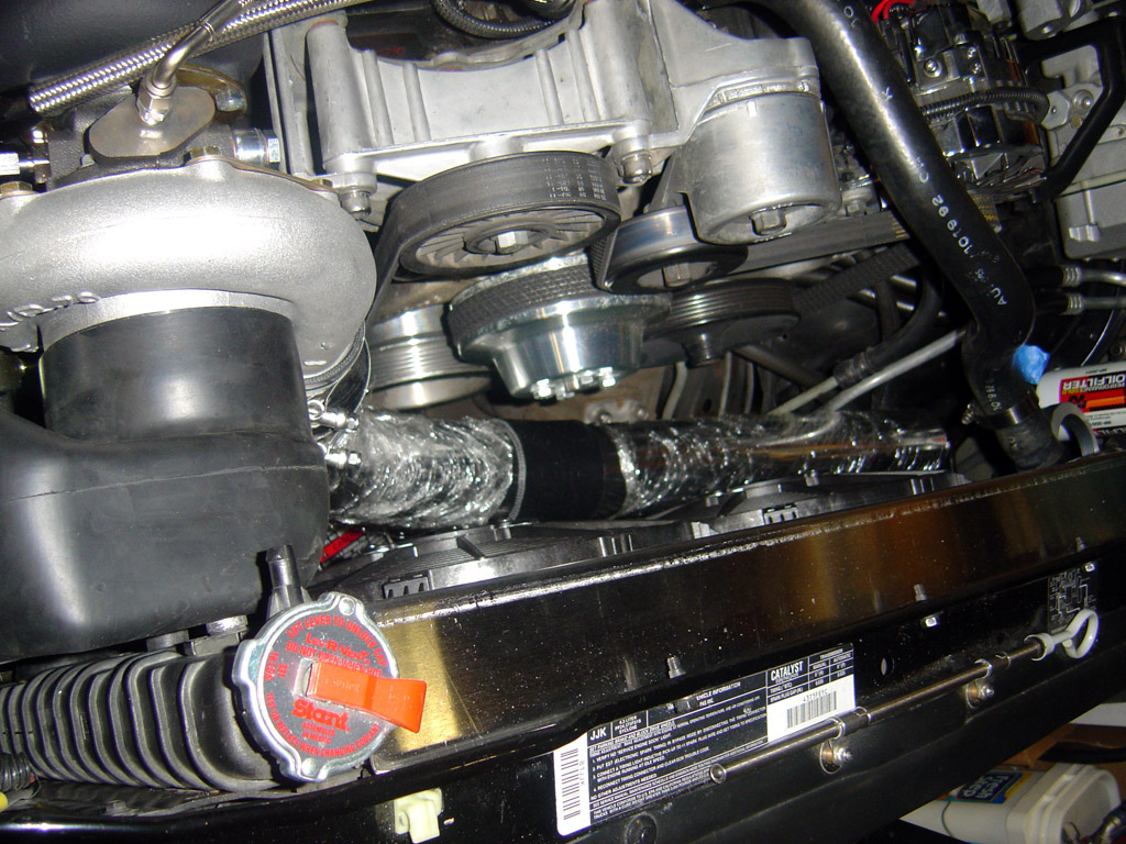

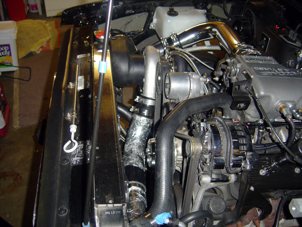

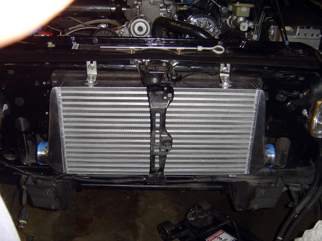

I plan to have A/C and since I will have to move the cooler forward I had to modify the hood support bracket. I had a guy cut it and weld a plate to the back to have room for 2 more bolts. It sits on there great and works perfect. I also had the turbo polished. When I get the front mount, brackets, alternator, and some other stuf back from the polisher and powder coater(I expect tomorrow). I should start putting it back together and hopefully have it off to Waller for wiring, plumbing and tuning. This is what I have now.

Got it ready for Waller now. All the parts I was waiting for came in. I am pretty happy with the way it turned out. Pics arent as nice as I'd like because the sun was too bright so I had to use flash and close the garage door. Any way pics are here.
