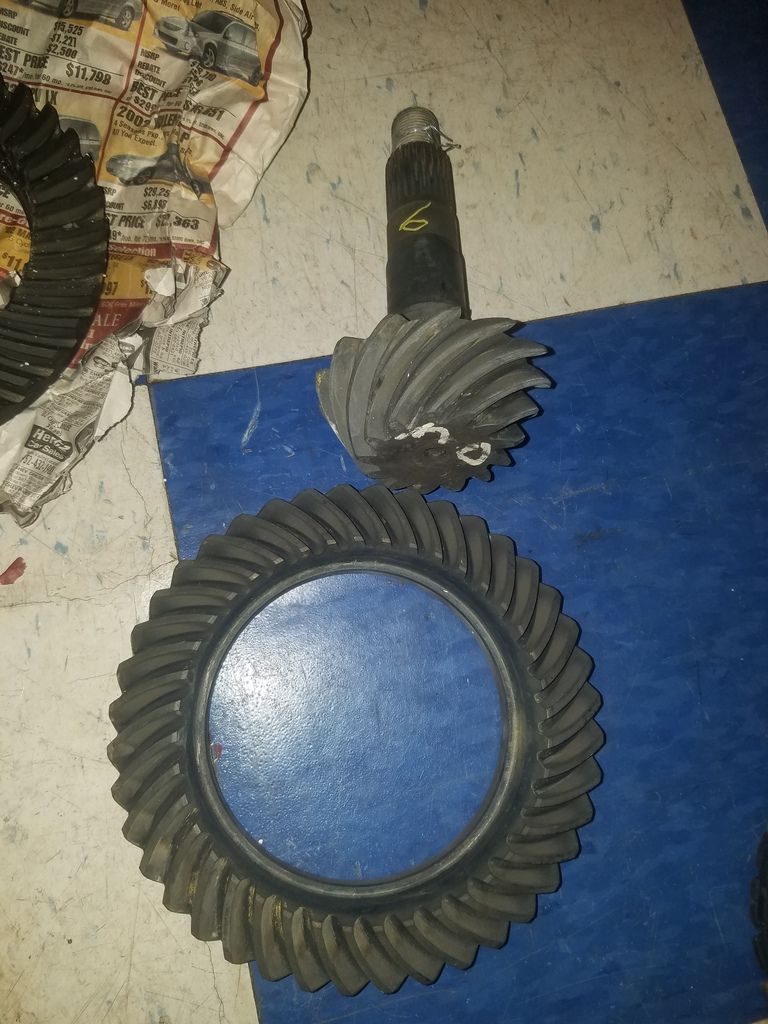

I have a set of 308 gears that I picked up for testing. We are going to see if they fit on the torsen carrier and if there is enough adjustment on it. We will see... But we have 3.42's ready and they have been proven...

We do have trailblazer SS front differentials with the torsen unit. The 3.08 gears will not fit in the case. the pinion gear is enormous and will not fit. we have tried... We do have 3.42 3.73 and 4.11 gears and have all of them in stock! Send me a message with what you need since I could not read the post.

I did not get the entire assembly. I just got the gears. The pinion gear is huge and makes any adjustment for a good pattern extremely difficult.

The problem is due to the size of the pinion gear. It is massive...

I get that. I'm proposing a way possibly to work around it. By shimming the case halves apart, I can increase the distance between the ring gear and the pinion and allow for a bigger pinion. What I don't know is: How far apart do the case halves have to be shimmed to get a good pattern? 0.050"? 0.060"? 0.500"? 0.600"?
The only way to tell is to start trying. Install the pinion and assemble the unit with washers in between the case halves and extra shim behind the left carrier bearing... Once there's a good pattern, measure everything and figure out what the thinnest shim between the case halves can be.

It still costs us over $100 in bearings and parts to even try... I could sell you the gears if you want. They have already been cryo treated...

This is an upper limit, because the actual pitch diameter of the ring gear is smaller than 7.25", but...
Assuming the ring gear's pitch diameter is 7.25", then:
3.42 pinion pitch diameter = 2.120"
3.08 pinion pitch diameter = 2.354"
So the 3.08 pinion is only 0.234" larger in diameter than the 3.42 pinion, which is 0.117" larger on the radius. That means 1/8" shims between the TB diff case halves should be more than enough.
Of course that also @$$umes that the 3.08 ring gear isn't any thicker than the 3.42 ring gear. I don't know how far GM moved the flange for the 3.08 carrier, so I can't say whether that's a valid assumption or not.
