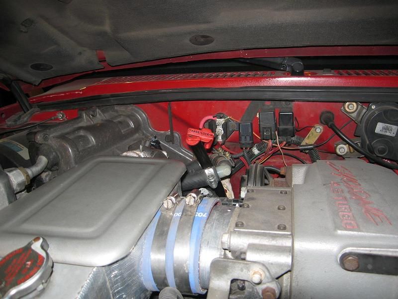

PATC sells an OEM-style 4L80E dipstick tube with a locking dipstick that fits in our trucks like the stock one. It bolts in the same as stock and clears the block and firewall with no problem. The only difference I noticed is that it is about 2" longer than the 700R4 one. My 4L80E came with a shorter dipstick tube, so I cut down the PATC tube and used the other dipstick. The PATC tube should still clear the hood with no problem without cutting it. If you do cut it down, the full marking on the dipstick should be even with the bottom of the transmission case / top of the pan gasket.
My truck doesn't have the stock intercooler hard lines anymore, so I can't confirm it will clear those, but it looks like it's in the same position as the stock tube.
