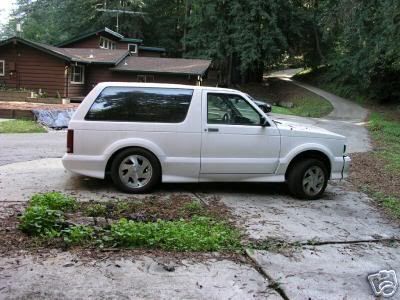

That's how mine was when I bought my ty. I got a new set with it, but have steeel ones in there now.
This is how mine sat.
