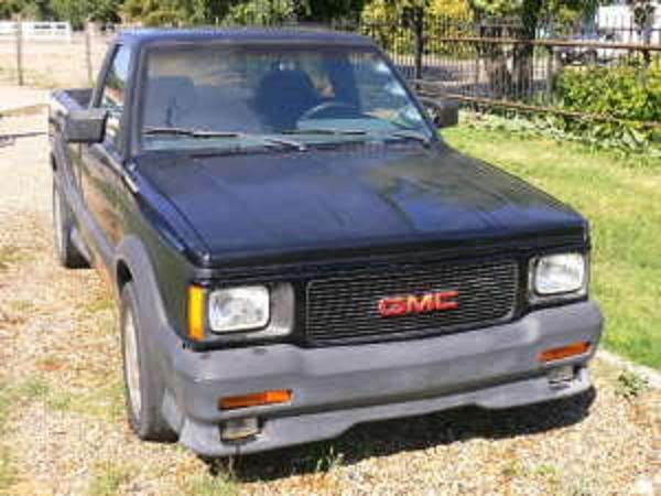

Bought Syclone #1784. Here's a list of what is done with the truck since being pulled outta the weeds at 102k miles or Aug 2007, thx sean:
Ingredients:
One beat to hell Syclone
Rebuilt stock block:
.030 over TRW forged pistons
L35 rods
polished crank
balanced internals
comp 412 cam
Stock heads, 1.60/2.02 valves
Ported and powder coated upper intake
3 bar MAP/ using the 2 bar currently
BBZA 1576 OEM chip
Stock injectors
New ECM relocated to glovebox
Innovate Wideband (LC-1)
Colbalt boost gauge
Pillar Gauge pod (3pods)
Brake Booster Hose w/ Gauge Port
SY0237's Silicone (stocker replacement uses 4mm hose = 15ft & 6mm hose = 10ft.)
Walbro 255 fuel pump
Throttle body airfoil
Acufab AFPR
MSD distributor
MSD coil
Taylor wires
NGK spark plugs
High temp boot covers
RPM stage one turbo by Turbonetics (50mm, 450ppm, 3inch inlet)
Hose assembly- Turbo oil drain
3' Cobra elbow
Turbonetics Raptor BOV
Blitz sd-III Boost controller
V-block http://www.gofastgoods.com
Aluminum hard pipe w/bov flange
Flex a light mechanical fan w/ spacer for A/A
B&M trans cooler
Battery relocation
Battery cut off switch (right tail light)
Derale deeper tranny pan ''Turbulator Cooling Tubes''
Derale remote tranny cooler w/fan and thermostat
catless 3" exhaust with borla XR1 muffler (off stock down pipe) Sounds SOOO SICK!!
ABS delete
A/C delete
EGR delete
Cruise control delete
160 degree thermostat
George Blakes front shaft
Upgraded steering shaft
Typhoon side mirrors (not power
Typhoon blacked out grill
Beltech front and rear swaybars
Beltech 3''drop springs (without overload springs)
Beltech 1'' drop block
Set back plates
CBR Battle Bars
KYB Shocks (565064) Rear
TurboTime front coil overs
18' H2 Hamanns
Custom door panels
Johnson intercooler pump w/soft lines
RPM Fuel pressure guage
K&N push in breather
K&N RX-2320 intake
Clifford Alarm w/ keyless entry
New brake pads
New radiator
New alternator (powder coated blades)
New gas tank
New heater core
All new -8an braided fuel lines
All new cooling hoses
All new engine sensors
All new oil and tranny lines
New Alpine Deck
Only mobil one synthetic
never seen any less then 100 octaine.
What's next?!!!
Alky
??lb injectors
CAI
Custom tune (researching and taking suggestions, leaning code59)
911/2800
3' downpipe
4 wheel disc brake conversion
& probably a new :2gun: tranny
Lots of paint prep, PAINT is a must!
This build is up to about 16k so far....
